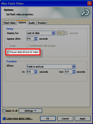

    August 5, 2009
    Hi Steve
    Unfortunately the "Pause slide till end of video" option has been there since Captivate version 2. I just fired it up to double-check.
    Here is a screen capture:
    Click the image if it's small to view at full size.
    If the option doesn't seem to be working, please consider submitting as a bug. (Link is in my sig)
    Cheers... Rick
