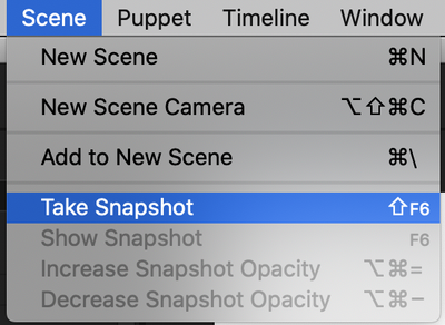

What oshiro was showing is you can take a "snapshot" of the previous frame, then show it when you go to the next frame. I shows it transparently, so you can know where the character just was and where it is now. That is why he did it one frame at a time. In English:
The other way is to use multiple behaviors, recorded separately. E.g you can add more than one Dragger behavior to your puppet, then use one to record dragging the body. Then use a second dragger for the left foot, a third for the right foot, etc. Record the first dragger (body) first, then go back and arm the left foot dragger and do that. Its a bit of a pain, but it lets you see the other draggers in place while recording a new one.

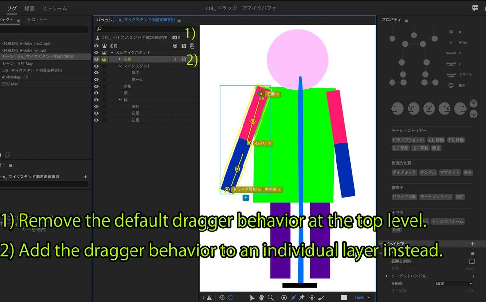

Feb 12, 2021 Feb 12, 2021
I'm not very good at English, so I'm worried if I'm understanding your intentions correctly.
When I add a drag behavior, the other parts move with it.
Here is how to solve it.
1) Remove the default dragger behavior at the top level.
2) Add the dragger behavior to an individual layer instead.
3) Check ”Limit range”.
The dragger behavior will move only in that layer.
I recently posted a tutorial on YouTube on how to do this. It is in Japanese, but I hope you find it useful.
https://youtu.be/Lt20eAkEd7E?t=457
