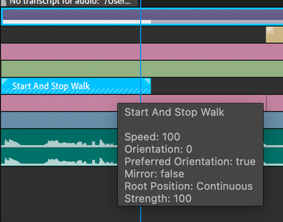

I want my character to start walking from right to left starting from offscreen onto the screen. I do "Record One Motion" and set the character off the screen using - Anchor Point X.
The walking is fine; Character walks fine, but when the take finishes, it slides back to off screen.
I use motion library walking behavior- attaching screenshots.

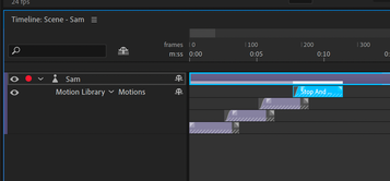

I think of Motion Library as a bunch of one-off gestures. So many of them don't continue moving when they "finish," they restart and do the take over and over again.
You could use the normal Walk behavior to get around this, or you could keep duplicating and blending the same take to have the character keep walking to the side. I just tried with with Sam on the home screen of the app and it worked, she kept starting and stopping.
