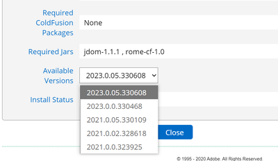

Hi, thanks for the answer, this solution only works if I install the 2023 version of the packages, but not with 2021 versions
