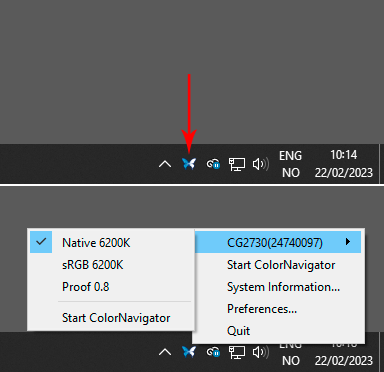

In Eizo Colornavigator you can do it in the main software interface - but there is also a separate component that loads in the Windows system tray, where you do that.
Look for something similar in the BenQ software. I've also used NEC Spectraview II, where (IIRC) there was a standalone utility packaged with the softwar

I don't know the BenQ software, but this sounds strange. It has to be able to switch calibration target and load the corresponding profile in Windows. That's a core function.
Look for something similar in the BenQ software. I've also used NEC Spectraview II, where (IIRC) there was a standalone utility packaged with the software, that did the same thing and worked the same way.
Note that you still have to relaunch color managed applications to load the new profile. This is how all color managed software works, that's nothing special for Adobe applications.
