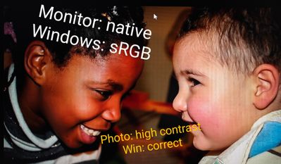

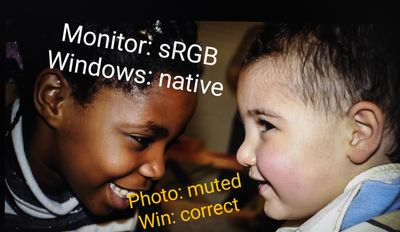

I have a BenQ SW270c which is a hardware calibrated monitor: this means the calibration software (Master Palette Element or MPE) is not running in background in Windows 11: it is just used to create the calibration profile to be stored in the monitor  itself.
If I set 3: Native (or 1: aRGB) my photos in Lightroom (and in any other color managed software: Photoshop, Chrome, Microsoft Photo, Fast Raw Viewer) look correct WHILE all Windows GUI elements (i.e. icons), the photos' thumbnails in file explorer, Office etc (that is all non color managed software) look overly contrasted.
If I set 2: sRGB the non color managed software look good BUT my photos in Lightroom look flat, with strange colors.
Am I doing something wrong?

Well, guess what? Indeed I found in  Windows/System32/Spools/Driver/Color all three ICM files created by PME.
I was being deceived by the fact that in monitor's properties, under the cor profile drop-down list, I would see only one option: the profile generated during last calibration, that is native. So based on what I read on BenQ 's website I guessed that was normal. Nowhere was written what I was supposed to do: go into advanced monitor settings, add the three color profiles by selecting the three ICM files and set the one I wanted to use. And the last part (set the color profile to be used, to match the monitor calibration) has to be done manually each time I change the monitor calibration. And this is stupid, and I don't know why BenQ does not have a dedicated app in system tray to do what Eizo does: change the color profile in Windows and the calibration on the monitor. Who cares if you can easily change the monitor calibration with a press of a button if then you still to go into monitor's advanced settings to change the color profile. Luckily I found a small app named Display Profile that allows you to choose the correct color profile.
And the funny thing is that BenQ does not suggest to do this! They say: calibrate monitor in native, load the generated ICM color profile in Windows and if you want to verify how your edited photo looks on 99% of monitor's (non calibrated sRGB) just use the LR color proofing (living with the super saturated colors of non color managed SW). Now LR color proofing is annoying, as you still need to select in LR the color profile of your output: the printer's specific in case of printing or a generic sRGB in case of web publishing. So clicking on the puck to choose sRGB calibration would be faster, but I've just learned this is not enough, I also need to set in Windows the correct color profile. How stupid...
