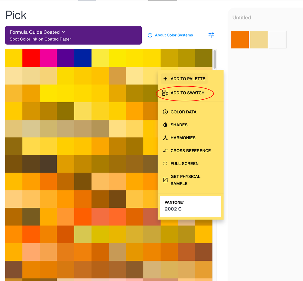

Their FAQ states that you can pick any of the 15000 colors with the Basic version, but my trial has run out and if I try to add a swatch to my InDesign Swatches panel, the Basic version won’t let me. When Add to Swatch did work the extension seemed better than installing .acb libraries—much easier to search and add swatches:

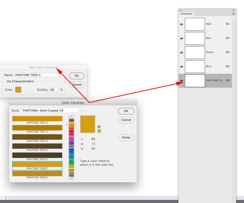

I guess the question is whether new CC versions are going to stop supporting .acb files—the Photoshop Color Picker’s Color Libraries access the .acb files in the Photoshop Color Books folder. It contains other books e.g. TOYO, so stopping .acb support would affect other ink vendors as well.
Here I’m using the same .acb files I use in InDesign, which were exported from Pantone’s Color Manager:
