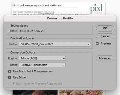

@bsomberg If you have a CMYK file and are saving it - you should not be being asked if you wish to embed an RGB ICC profile, that’s an error.
Are you SURE it’s a CMYK file?
Did you use edit>convert to profile and set the print provider's recommended ICC there?
Look at the bottom left of the Photoshop interface - there's a little info window which can be set to ICC profile.
as you can see, this image is sRGB - -
Here's how an ICC conversion is done in edit>convert to profile, I used Relative Colormetric and GRACoL2006_Coated1v2.icc:
I click OK
AFTER the conversion I see this - the Photoshop info panel clearly shows GRACoL2006_Coated1v2
Yours should show whatever CMYK profile you used in the conversion

@bsomberg You write: "I do see the indication that it is a CMYK file with the profile to which I intended to convert.  When I save the file if I leave the option concerning "embeding an RGB profile" CHECKED, it appears that everything is working ok."
When you save a CMYK file you should NOT see anything about embedding an RGB profile, but the screen I show below,  which shows the relevant CMYK profile.
IF the dialogue [below] on your machine shows an RGB profile next to the Embed Color Profile checkbox, something is amiss.
You SHOULD be seeing the below (with the specific CMYK profile you chose in the conversion, of course you MUST choose the CMYK ICC profile that your print provider recommended, do not use my example profile.

Guide ,
Jul 24, 2024 Jul 24, 2024
Adobe applications will never ask to embed a profile that is not the color space of the file you are saving.  If that is the case for you, then just uninstall the application and reinstall it because that is a serious bug.
The normal dialog is to "Embed Color Profile"  That dialog is for whatever color space your file is in at the time you save it.  Always embed a profile in any saved files.  That profile will then travel with the file and make sure other color management systems know what must be done to create the best possible reproduction.
