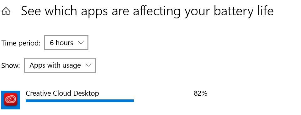

Jun 12, 2020 Jun 12, 2020
Surprisingly the issue persists even in 2020. At least 2 years since it was reported and Adobe unable to find root cause?Creative Cloud Battery Usage.JPG

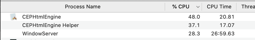

Jul 28, 2020 Jul 28, 2020
The battery drain with InDesign is has basically made my laptop MacBook Pro and MacBook Air useless without a power cord. Even when sleeping 100% the battery is drained. I was able to see the battery drain in Activity Monitor. These two porcesses are hogging resources and only active when InDesign is open. When I close down InDesign, these go away and the laptop temperature goes down.Screen Shot 2020-07-28 at 8.27.31 AM.png
