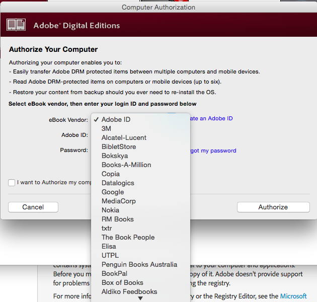

After being unable to download books bought on Google Play via acsm, getting the E_ACT_NOT_READY error, I did as others have suggested and deleted the (hidden as derekdokoto  mentions). I then tried opening one of my Play acsm purchases and got this authorization screen:
Previously I had used the default Adobe authorization, not realizing that you can put in credentials for the specific book vendor.
Rather than go through the trouble of entering my various logins, I chose to continue without authorizing, because I wanted just a couple of specific books to read while traveling:
As an aside, my multiple attempts to download the books from Play resulted in their servers thinking I had reached the limit for the number of devices to which I could download, even though all the installations failed! I had to get Google Play support to reset my device limit, then all was well.
