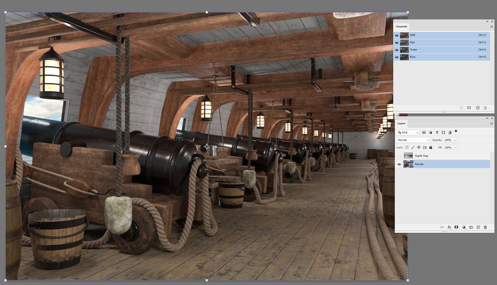

Feb 07, 2022 Feb 07, 2022
Here is a quick example.
I started with a render for which I also output a depth mask in the same format as you had from Dimension /Stager (light close dark distant)
To this I added :
1. A Gaussian blur using an inverted depth map as a mask so that the blur affected the distant objects more than the close ones
2. A Curve adjustment layer  darkening the image - but again using the inverted depth mask as a mask to increase the darkening with distance
3. A Hue and Saturation adjustment -reducing saturation but using the inverted mask so that saturation reduced more in the distance
4. Another Hue and Saturation adjustment layer, this time increasing the saturation and using the straight copy of the mask so that saturation was increased more in the foreground
No re-rendering - just making use of the depth mask based on distance.
I'm not suggesting that this is the way I would adjust this rendered image, just demonstrating how you can make use of the depth map.
Dave
