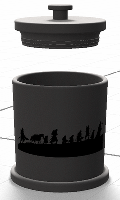

It appears the UV unwrap has several polys scattered butt they're likely to be from the trim, not the cylinder of the jar. I'd say the large canvas UV is correct and provides good mapping for the decal. However, I'm fairly certain there's a technical issue unrelated to the mapping.
Here's a decal moved to both sides of the jar:
There's no issues with clipping or flipping on the light or dark side of the jar. The moment I increase the scale it goes back to clipping and distorting:
