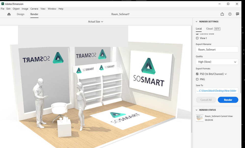

Hi there,
when i create a rendering, i always get white/transparent blocks in the result. Same at PSD and PNG and on WIN and MAC:
I did not had this problem in 2.3 ... and yesterday, i also made a rendering from exactly the same file in 3.1 ... and it works! Today ... not!
In Photoshop file, the problem occours only in the layer "noise reducted". So it seems to be a problem with the de-noising!?
Best regards, Ralf
Okay ... seems to work. BUT: turning down opacity and Roughness makes part of the Wall invisible!? That should not be.
This is also the reason why the windows seem not to be in place.
I went back to 2.3.1 for the moment. Its a pity cause newer versions are faster, better to use und the renders look better .. apart from the blocks in some renders.
Question to adobe: Will you fix this problem in further update?

1. sounds like a known issue... here is another one
https://community.adobe.com/t5/dimension/empty-squares-in-rendered-image/m-p/10788116?page=1
2. to be sure I would need you to share the Dn file but the fact it happens in the de-noising step make me 80%; custom materials, hidden layers and incorrect lighting are the 3 ways to make this effect i.e, Dimension drops the data because it doesn't understand what else to do

I got your file and yes it is the same issue so you have two basic options;
also note the small errors in the front view are because your wall isn't 100% correct in placment... this may or may not matter, depends on the camera angle
noise in rendor
option 1
option 2 - remove cause
back view repaired
front view with small errors
Copy link to clipboard
Copied
yes but if you need the wall visible turn the opacity back up to 100% without the roughness there will still be a lot less noise and you shouldn't get as many squares
another option is rebuild the model or of course use older builds as you did... at the end of the day its up to you mate but Adobe is unlikey to fix anything this random
Copied
"at the end of the day its up to you mate but Adobe is unlikey to fix anything this random"
I don't agree with that. I don't seem to be the only one with this problem. In my opinion, the de-noising function (which obviously still works in 2.3.1) is simply still broken. If the software fails with such a simple model, then the task here IMHO clearly lies with Adobe.
Thanks for your help. With roughness completely downregulated it works at least.
