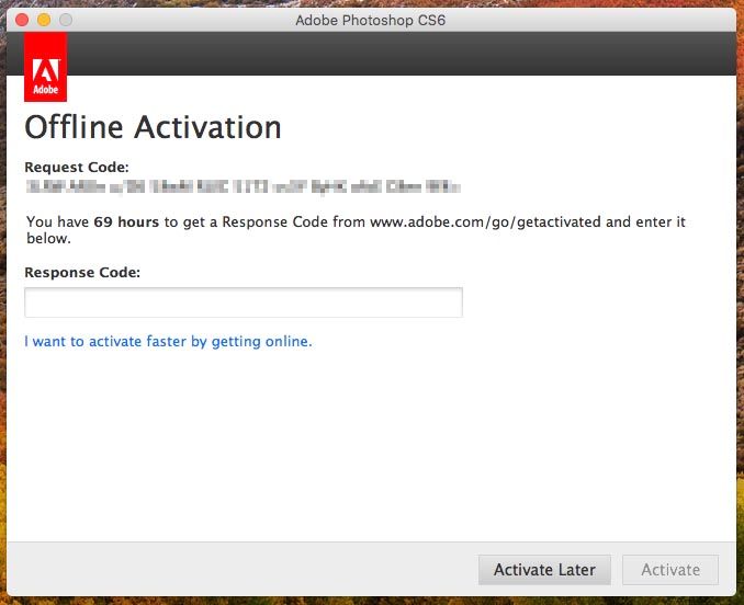

Regarding your question kglad as to whether he/she used "OFFLINE ACTIVATION"
I do clearly recall seeing the Adobe agent at these windows so presumanly he/she used Offline Activation.
At one point in the proceedings I also briefly saw a window stating my Serial Number(s) had been "Validated", not exactly sure where that was though as things were moving pretty fast.
