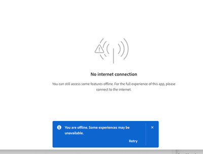

Did the dump, restart; update appears in CC, slect update, starts, runs for a bit then get a message  'no internet', which is not so. Shows message for a bit than stops for a bit, then shows again, over and over.
Sep 05, 2025 Sep 05, 2025
adobe connection errors are common and are not related to whether you're connected to the internet.  they're related to connecting to adobe's secure servers.
if you have a non-current os, your default browser must support tls 1.2, https://helpx.adobe.com/x-productkb/multi/eol-tls-support.html
to test your default browser's tls you can use , https://clienttest.ssllabs.com:8443/ssltest/viewMyClient.html
otherwise, confirm that you can connect to the secure adobe servers by reading, http://helpx.adobe.com/x-productkb/policy-pricing/activation-network-issues.html
do you see both logos after clicking "link"?
if you can and still see a connection error try these steps, https://helpx.adobe.com/download-install/kb/common-network-connectivity-issues.html
if those all fail, white list the adobe network endpoints, https://helpx.adobe.com/enterprise/kb/network-endpoints.html
