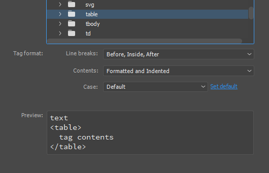

Go to Edit Tag Library to set up your code formatting rules.  You can reach it from the Apply Source Formatting tool.  See screenshots.

Thanks for the reply, but I already had that set, and I am still not getting the extra line and indenting between the tag. When I close the opening tag, it creates the closing tag with the cursor between the tags, but when I press enter, it just moves the closing tag down to the next line without creating and indenting the next line. See the screenshots below.

Thanks for the reply. Sorry I didn't get back to you yesterday. I pasted the code in and clicked Apply Source Formatting, and I got the following. Also, if I hit enter between the td tags, it still just moves the closing tag to the next line, It doesn't add an extra, indented line.
Nov 14, 2018 Nov 14, 2018
I think the short answer is the code formatting option isn't working 100% as it should in Dreamweaver
I tested at my end with Dreamweaver CC 2019 (on Windows 10) and get the same result as you. If you look on the uservoice website you'll see that there have been niggles and issues with Dreamweaver's code formatting option since CC2017 when Brackets was embedded into Dreamweaver as its new code editor.
My advice is report it to Adobe Support and/or post on the uservoice website.

Thanks for the response. I was afraid something like this may be the problem. I reported a bug on the Uservoice site, and will update this if I hear anything.
Until then, I am going back to using Aptana. It may be a minor thing, but it slows me down if I have to go through formatting my code myself, and I have enough to do that I don't want to be slowed down.
