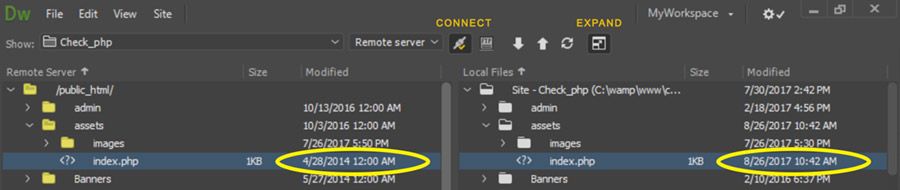

Expand your files panel to compare Remote & Local Files side-by-side.
Their structure should be similar.  See screenshot.

Evidently you pulled all files from your server instead of just the relevant website files.
Contact your hosting provider and ask them where your website's root directory resides.
See screenshot.  Mine is public_html.  But yours could be www, webdocs, html, htdocs or something else entirely.  It varies by hosting plan.
