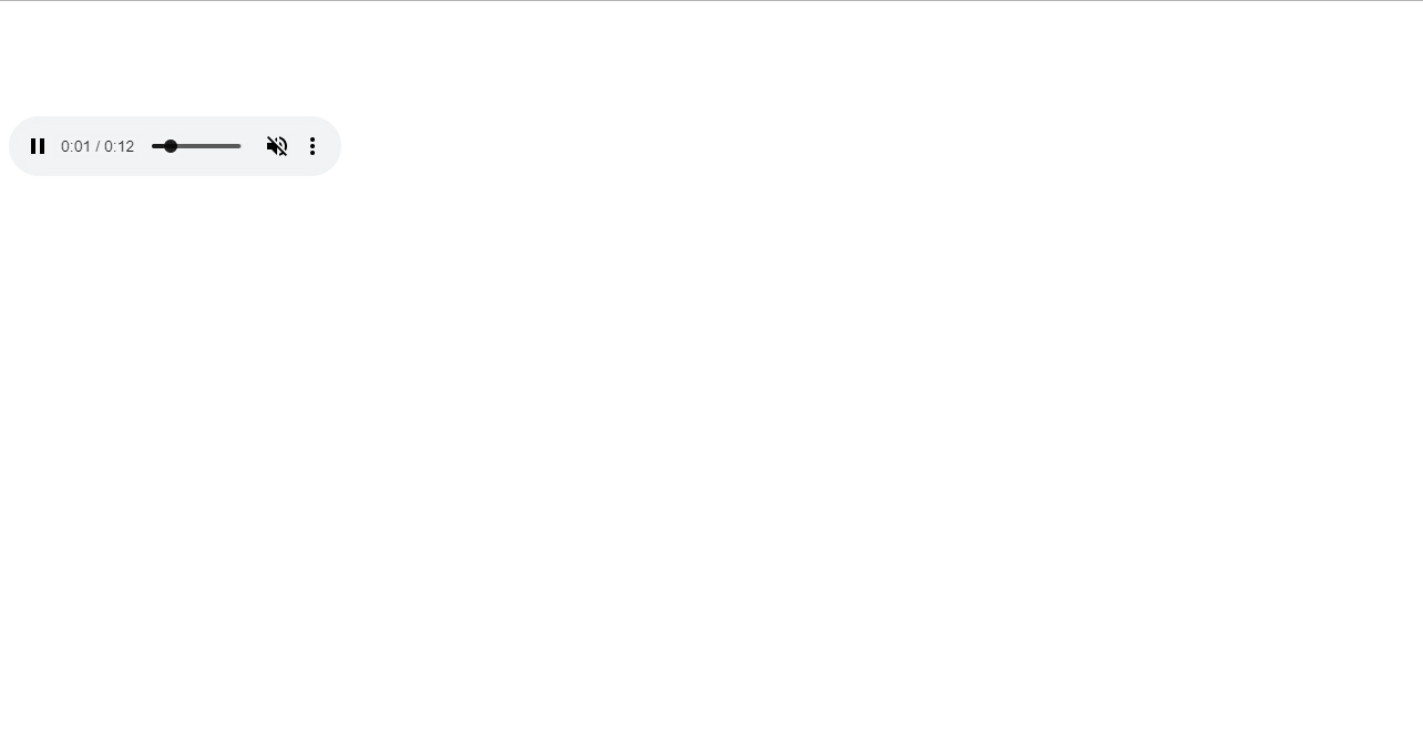

i tried this but still doesn't show, i also tried adding controls, all i can see is the controls but not the video nor its poster

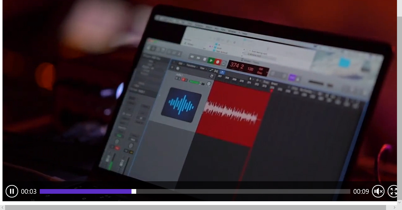

Microsoft Edge
Google Chrome

Chrome is reading the play time of the video file, as it is showing the length of the video in the controls. Which indicates the file format may be the problem, the poster image will not show in such circumstances.
Have you tried including the video in webm format or any other format along with mp4?
