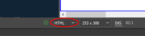

Try switching to HTML from the document type drop list.  See screenshot.  Then try Emmet shortcodes.
