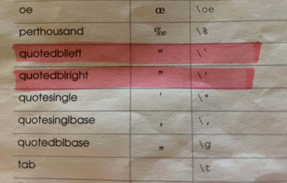

My expertise is explaining FrameMaker features—I'm a FrameMaker instructor—and know nothing about C programming. I won't be able to be of further assistance other than to share this shot of my dog-eared Fm 5.5 shortcut book. From this you can see that in a dialog box,  \" is an straight apostrophe (in the US it is used to indicate that a value is measured in feet) and \' is a close curly quote.
~Barb

Really, his question was not C-related. He was just trying to illustrate his point that way.
His question was simply whether there are escape sequences to generate curly single quotes as well as curly double quotes?
Jun 23, 2022 Jun 23, 2022
Ha! I thought I could go back to the InDesign forum. 😂
The plain apostrophe on the keyboard is used for the right single curly quote in a dialog box. (And the grave apostrophe is used for the left curly single quote in a dialog box.) No extra characters required.
~Barb
