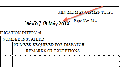

thanks a lot for your reply.I am trying to make a template for aviation manuals.There is a requirement to have page revision status, that means that I have to enter a date to every page and list this (List of effective pages) in the front pages of the manual.I did this with a paragraph format in a second text flow and a list of paragraphs generated file.The problem is that I have to manual enter in every page the text frame that includes the paragraph format.

I thought that a script can help.If you have any other recommendations or solutions or alternative ways to perform this task I would be very happy to hear them.I am not familiar with javascript but I have done loads of scripts in Filemaker.Any help will be appreciated.
Idealy a way to enter this into a 2-page layout (left/right).but if it is a hassle I can convert all layouts to single page.

The initial issue has the same revision number and revision date.I can not do this with a variable because the list of paragraphs does not get information from master pages.The way I found to make this work is to have a separate flow or a text frame in every page (With its own paragraph format ,in this case LOEP).So when I generate a List of paragraphs , I get the List of effective pages.Now the "problem" is when I want to put the text frame in every page.I can copy the text frame, click on next page icon in frame maker,paste the text frame and go on until I reach the end of the document.So I thought to automate this with a script.
I think this is very simple to do ,but since I have no experience with javascript it is difficult for me.Anyway since I am an aircraft engineer and I like challenges I made some progress with my own script.
