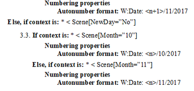

The "SceneDate" Element has autonumbering that is populated based on the "NewDay" and "Month" attributes on the "Scene" element:
QuintinSeegers_Personal_0-1733175866034.pngQuintinSeegers_Personal_1-1733175884648.png
The "SceneNumber" element has autonumbering that simply numbers from 1 onwards:
Nothing unusual about these element and they're working as expected. This EDD is used in a Master document.

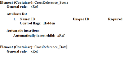

I have another EDD that is used in a different document, which will cross-reference back to the "SceneDate" and "SceneNumber" elements in the Master document. In the EDD for this document I have "CrossReference_Date" and CrossReference_Date" elements:
QuintinSeegers_Personal_3-1733176317832.pngQuintinSeegers_Personal_4-1733176344273.png
Again, these work as expected.
