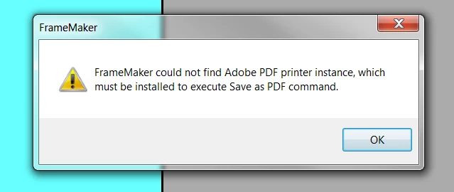

This is the error that I received everytime I have to save my graphic into PDF file. Any solution?

It looks like your installation is incomplete. You should have a printer called "Adobe PDF" installed. FM uses this to create the postscript that is distilled into the PDF.

Check your system printers to see if you (still) have an AdobePDF printer instance.
If you do NOT, then you'll need to re-install. If you have Acrobat, then first try running a repair (Help menu) to see if that resurrects the printer, if not, re-run the Acrobat installation. If you did not have Acrobat installed, then you'll need to re-run the FM install to get the PDF creation option installed.
If you do still have the AdobePDF printer instance installed, test it using the system "create a test page" option in the printer properties. If that works, then make this printer the system default and try to create a PDF from FM. If the test page fails, then it's probably easiest to just to go through the re-install scenarios mentioned.
