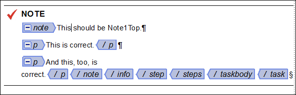

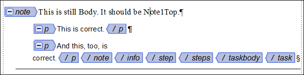

We need to have our <note> element so that the first or only paragraph is *not* wrapped in a <p> element. However, we want to add additional <p> elements after the first paragraph when necessary.
Here is what we want:
Here is what we get:
I have defined the following paragraph tags:
Note1Top (includes the frame above with the Note graphic and the rule)
Note1Middle (no rules and no graphic)
Note1Bot (a bottom rule and no graphic)
Note1 (use for scenarios where there are no additional paragraphs)
I have defined the <p> elements in my EDD and they are working correctly. I need to figure out how to define my <note> element in the EDD so that it uses Note1Top when they are child paragraphs or Note1TopBot when there are no child paragraphs.
Currently I have this in my <note> element in the EDD:
Else, if context is: note < (stepxmp | stepresult | info) < step
     1.1.7. If context is: {first}
                    Use paragraph format: Note1Top
               Else, if context is: {only}
I think the reason that the {first} and {only} sibling indicators are not working is that there are no siblings.   But what is my alternative?
Thanks in advance for any help you can provide.
Marsha

Hello Marsha,
what you are trying, is to use something like an XPATH expression, like in a XSLT stylesheet.
With FM this simply doesn't work. You cannot test for child nodes in a context rule.
If you are working with raw XML files and not FM files you could define a XSLT to be used as preprocessor, that could set an attribute  which could do the trick.
But as Scott already mentioned, that is something not being exactly best practice for such a case.
It would indeed be easier to not place text directly into the note element and use a <p> element even if there's only one paragraph.
You could then test for this in the context rules for <p>, as parent/sibling rules are included in EDDs.
-Alex

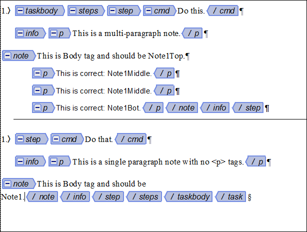

I am so-o-o-o-o close. I'm sure that there's a way to do this. (Okay, I admit it. I'm stubborn. )
Here is what I have now:
In step 1 with the multiple paragraph note, all is well.
Unfortunately, in step 2, with just a single paragraph note, I'm not getting my bottom line. It is outputting Note1Top rather than Note1.
Here are my rules (in the <note> element):
Format rules for first paragraph in element
1. If context is: (stepxmp | stepresult | info) < step
    1.1 If context is: {only}
The above rule is not working as evidenced by the fact that I don't have a line under my second note.
          Else
This is working because whether I have extra paragraphs or not, I still get the frame above with the glyph and the line above.
Format rules for last paragraph in element
             Use paragraph format: Note1Bot
This is almost working because when there are multiple paragraphs in the note, the final one has the frame below which gives it the properly-sized line under it. So this is telling me that FM does not recognize an "only" paragraph as both first and last.
Under the Text format rules, because it isn't a first or last paragraph rule, I have:
Else, if context is: (stepxmp | stepresult | info) < step
              Use paragraph format: Note1Middle
This is working because the paragraphs that aren't first and aren't last are properly tagged with Note1Middle.
Does anyone have an idea how I can get a Note with no extra paragraphs to work?
Thanks in advance.
Marsha

Marsha,
   As I understand it, your <note> element can either consist of a sequence of <p> elements or of data characters (and I suppose inline elements as well). I disagree with Scott in that I believe this is a quite reasonable design. I see no reason why users should have to deal with <p> elements that are unnecessary. Even if they are autoinserted, they clutter the Structure View.
  It sounds like you can't change the design whether you like it or not, however, and your question is how to get the desired formatting. You'll need to split the formatting between rules for <note> and rules for <p>. In particular, <note> should simply apply pgf fmt Note1. This rule will take care of the case where there are no <p> elements in a <note>. Formatting of <p> within <note> needs to be done in a rule for <p>.
  In particular, use one rule that tests whether a <p> is within a <note> (distinguishing notes in steps from others if necessary) and then consider the different formats within a <note in a subrule:
  1. If context is: note
          1.1 If context is {first}
                Else, if context is {middle}
                Else
  A more robust variation is to use Note1 in a <p> that is the only <p> in the Note:
          1.1 If context is {only}
                Else, if context is {first}
                Else
--Lynne

Hi Lynne,
I am splitting the rules between my <p> element and my <note> element in my EDD. Here's what I have for the <p> element:
     If context is: {middle}
     If context is: {last}
Here's what I have for the <note> element:
Unfortunately, that results in the following output:
Notice that the first "paragraph" (no <p> tags) in both notes is the FM Body tag.
If I add the following to the <note> element, I get a better result, but still with no rule under the note with no <p> tags.
          Else
Again, the only thing missing is the rule under the note with no <p> tags.

Marsha,
   Your example has untagged text followed by several <p> elements. I was unaware that you have documents with both untagged text and <p> elements in the same <note>.
   How do the four pgf tags: Note1, Note1Top, Note1Middle, and Note1Bot differ? If they are the same except for the frames above and below, I would consider having three rules for <note> and none for <p>. In particular, in the definition of <note>, I would include:
1) A text format rule that assigns pgf fmt Note1Middle
2) A first pgf rule that sets the frame above
3) A last pgf rule that sets the frame below
Note that 2) and 3) produce the same result as applying pgf fmts Note1Top and Note1Bot except when the note contains only one paragraph, in which case that paragraph has the frame above of Note1Top and the frame below of Note1Bot. Further note that these rules apply both to paragraphs resulting from untagged text and those that are <p> elements.
With this approach you don't need to define pgf fmts Note1, Note1Top, and Note1Bot.
Of course, if there are other differences among the four current pgf fmts, the EDD may be more complicated.
--Lynne
