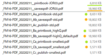

My FM2020 was 16.0.1.  I updated it to 16.0.4 and generated PDF by all three ways, however, the result was the same as before...  The generating speed was almost double: Print book was around 30 sec. and Save As PDF was 60~70 sec.
I also tried to generate PDF with the same fm/book files using the preset PDF joboptions by the two/three ways, since I usually use the original joboption.  The PDF files becomes big as well.  I recheck my setting a

Hello Jeff,
Thank you so much for your quick reply.
I also tried to generate PDF with the same fm/book files using the preset PDF joboptions by the two/three ways, since I usually use the original joboption.  The PDF files becomes big as well.  I recheck my setting and try again next week...
*JOR03 = the original joboption
*std = standard
*highQ = high quality print
*smallest = smallest file size
