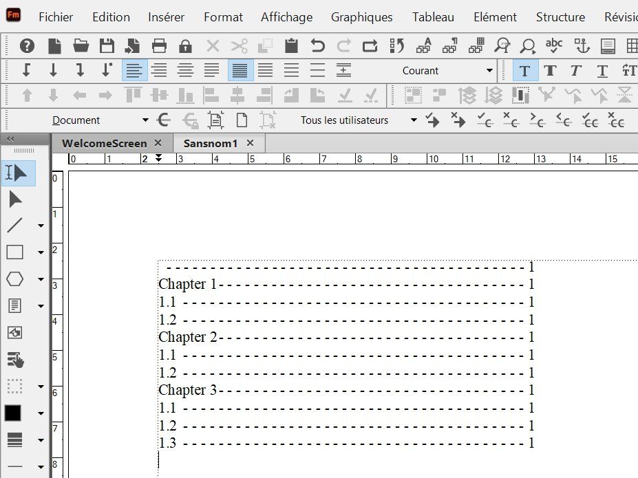

But here is the result :
- FM add a number "1" at the begining of the MTOC
-  FM add a number "1" at the end of each line
- I have no hyperlink inside the MTOC
And here is what I have in page reference :
Why do I have this result ?

Salut Pierre!
Thanks for starting out by showing us your reference page—that's the issue, of course. You results look confusing but Fm is doing what you are asking. The 1 at the end of the lines is the page number. Fm defaults to spaces between text and page numbers, you need to replace it with a tab and set the tab stop.
TestP1MTOC should look like this:
<$paratext>\t<$pagenum>
where \t is a tab character. You can type in the \t or just press the Tab key on the keyboard. In either case, you will need a right-align tab stop defined for the style.
TestP2MTOC should look like this:
again, you need to remove the space and add the tab. Then set the tab stop.
The 1 at the very top reflects that empty ¶ at the top of your first screen shot. No text, so Fm is just showing the page number. Head back to the body pages, View > Text Symbols to see it, and then remove it.
After making these changes, right click the MTOC on the body pages and update. This should straighten out the presentation. Let's deal with the links after it looks the way you want.
~Barb

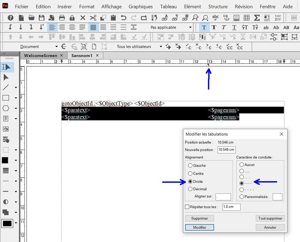

Hi Pierre:
You can add the blue color to the paragraphs, or just to the page numbers.
  • If you add it to the paragraphs as a paragraph style, you can do it either on the body pages or the reference pages.
  • If you want to add the blue to just the numbers, you can select them on the reference page <$pagenum> and assign a character style. Something to be aware of though, is that if you add a character style to a paragraph, the only clickable area will be within the character style. That means readers wouldn't be able to click the text and follow the hyperlink. They have to click on the colored page numbers.
Now, let's look at your first screen shot in your last post. You are very close. Double click the tab arrow you are pointing at below the ruler, change the alignment to right (first column), add the leaders (second column) and adjust the tab position. This is adding an override so be sure to update the paragraph style once you like how it looks. (That's why the body page didn't update in your second screen shot.)
Repeat for the other paragraph style, update the paragraph style and then update the MTOC.

Hi Barb,
In References pages, I have selected the two lines, and clicked on the top ruler to select a tab stop for the two lines.
Then I double clicked on the top ruler tab stop, and selected right (in left column) and the leaders (in right column) :
Result in References pages :

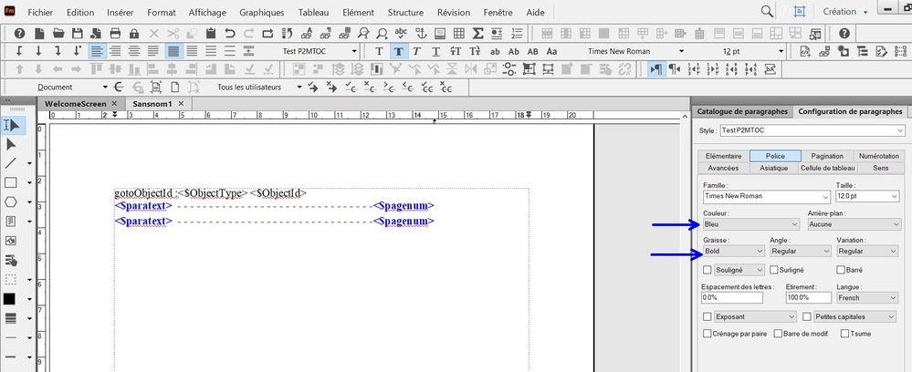

Now, about the blue color, in reference page I have set the font in paragraph style (for each line) on "blue" and "bold". But I see that only paratext and pagnum are in bold blue (the leaders are only blue but are not in bold. Why ?) :
I updated paragraph style in page reference and here is the result in body page :

Wow, Pierre. You have made great strides today!
What you are showing for the blue/bold combination looks correct in the Paragraph Designer but it should impact the entire line. Remove any character styles that might have been applied first and then try one more time—you must be tired by now so added a video to make it easier for you. Or wait until morning. We'll be around if you need a hand.

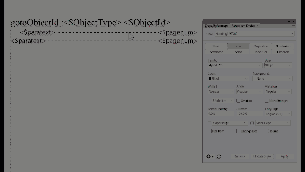

Hi Pierre:
This is what I see when I open your file—without doing anything at all:
I'm thinking it is a screen display issue on your end. Try zooming in, File > Print or File > Save as PDF. Do you see the blue/bold leaders after any of those steps? I didn't find any overrides so I think FrameMaker isn't sharing an accurate display.
~Barb
