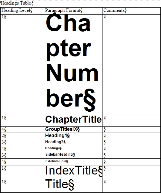

Hello all,

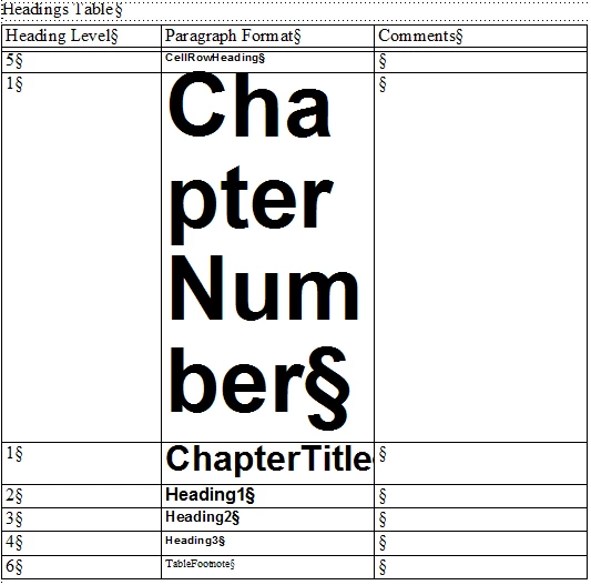

Looking at the reference page for a FM document (created by my predecessor) I see two mapping tables called "Headings Table":
and

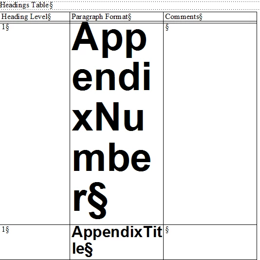

I also see this table and wonder why it is there (I would expect to see this table if the document I were viewing was an appendix but it's not, it is a normal chapter in the book):
Is there anything odd/wrong with this picture or is something just odd/wrong with me?

    Correct answer Matt-Tech Comm Tools
    You're viewing the HTML mapping tables, created circa v.7
    Unless you're using Save as HTML instead of the Publish pod, this method is a Very Bad Idea.
    Thus, you can safely ignore or delete these ref pages.
    Matt-Tech Comm ToolsCommunity ExpertCorrect answer
    August 3, 2018
    -Matt Sullivan, FrameMaker Course Creator, Author, Trainer, Consultant
