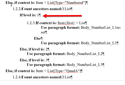

This is part of an EDD that I did a while ago:
I've never tried it but you could see if you can use an Else, if level is: 32 statement.

@Dave Creamer of IDEAS The Element content is all on the same level, not sub-levels, so the Level will always = 1.

Sorry, I meant you could use an if/else statement to restart the list via attributes. My arrow was in the wrong place--it should have pointed to the first line (and second to last line).
