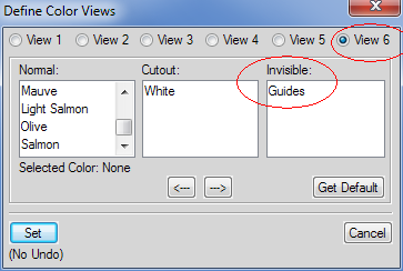

    The first step is to use FM's View > Color > Definitions... to create a new colour (I typically just use Magenta) and give it a name "Guides" (or whatever you want).
    Then use FM's View > Color > Views... to define View 6 to have the Guides set to be Invisible.
    Now you can use FM's drawing tools (line tool) to position horizontal and vertical guidelines using the "Guides" colour. Use the shift key to constrain the darwing movement to horizintal or vericatl when drawing the guides.
    If you draw these guidelines on your Master pages, they will be available on all document pages that use the respective Master page.
    To toggle the guidelines ON (i.e. visible) use <esc> v 1 and to toggle OFF use <esc> v 6. (These toggles also work at the book level for all files at once.)
