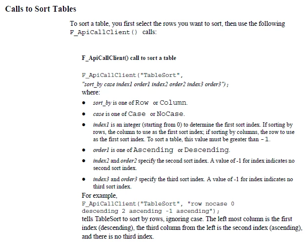

Here is how you can sort a table with ExtendScript:
#target framemaker
var doc = app.ActiveDoc;
// Set a variable for the selected table.
var tbl = doc.SelectedTbl;
// Select the table.
tbl.MakeTblSelection (Constants.FF_SELECT_WHOLE_TABLE);
// Sort the table.
CallClient ("TableSort", "row nocase 0 ascending -1 ascending -1 ascending");
Here is information from the FDK Programmers Reference for the TableSort parameters:
#target framemaker
// Sort the table.
