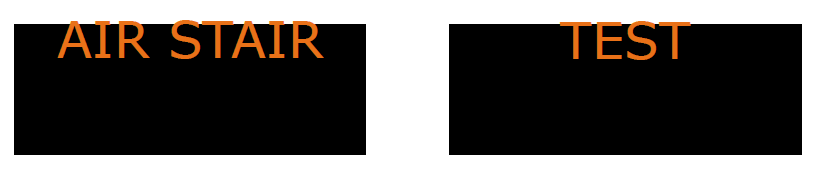

Hi folks,
I've a text frame that is cutting the text. How to resolve it?test_frame.jpg

Yes, this text clipping does happen and it is depending on the font metrics. There are a few fonts with which it doesn't happen (or to a lesser degree), but there is no distinct parameter in the paragraph or character formats with which it could be avoided.
However, I found an easy solution which allows you to precisely control the distance to the upper frame border. I suppose you're using a special paragraph format for these callouts. You'll need to modify this format as follows:

I think the case is different.
The text frame that I created is cutting the upper part of the word TEST, you are able to see the dash line above it. I would like to understand why and how can I manage the word to no be cutted by the frame.

Feb 02, 2022 Feb 02, 2022
This is the result in PDF...it doesn't cut but it's not align with the black frame.
1. On the Reference page, create a new empty graphic frame with a useful name (I've named it "Callout frame above" in the example shown below). Note: The name is given when creating the frame and cannot be modified afterwards! The title above is just text which does not control the frame's name. Make sure the frame  is transparent and does not contain any color fill:
2. Next: In the paragraph format, enable this frame to be used as "frame above".
Now you can use the height of this frame to control the distance of the paragraph to the upper text frame border.

Bernd
It works perfectly!
