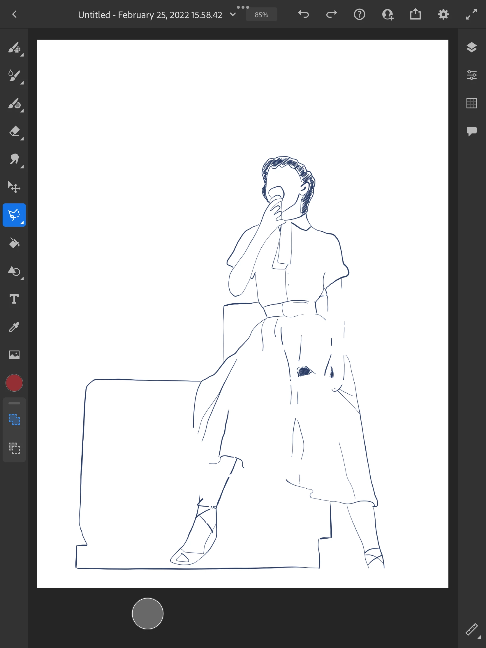

Hey so I drew this picture here, without the sporadic eraser marks everywhere.  I, very briefly, tapped around with the highlighted tool on the left, trying to figure out what it was, then suddenly my picture looked like this.  Despite the fact that I was working on it for over an hour, my file history shows that the picture wasn't saved, conveniently, until after whatever happened here.  Is there any possible way for me to get back my drawing?

Go on https://assets.adobe.com and log on. Click the drawing and at the bottom right you'll see a clock icon, click that and you'll be presented with different save times on your drawing. Click a time of your choice and the theee dots, there you'll see that you have the option to the revert your drawing back to that point. Here's an image of what I mean. Hope this helps.

Did you try pressing the Undo button at the top of the app?
The highlighted tool is the selection tool.
