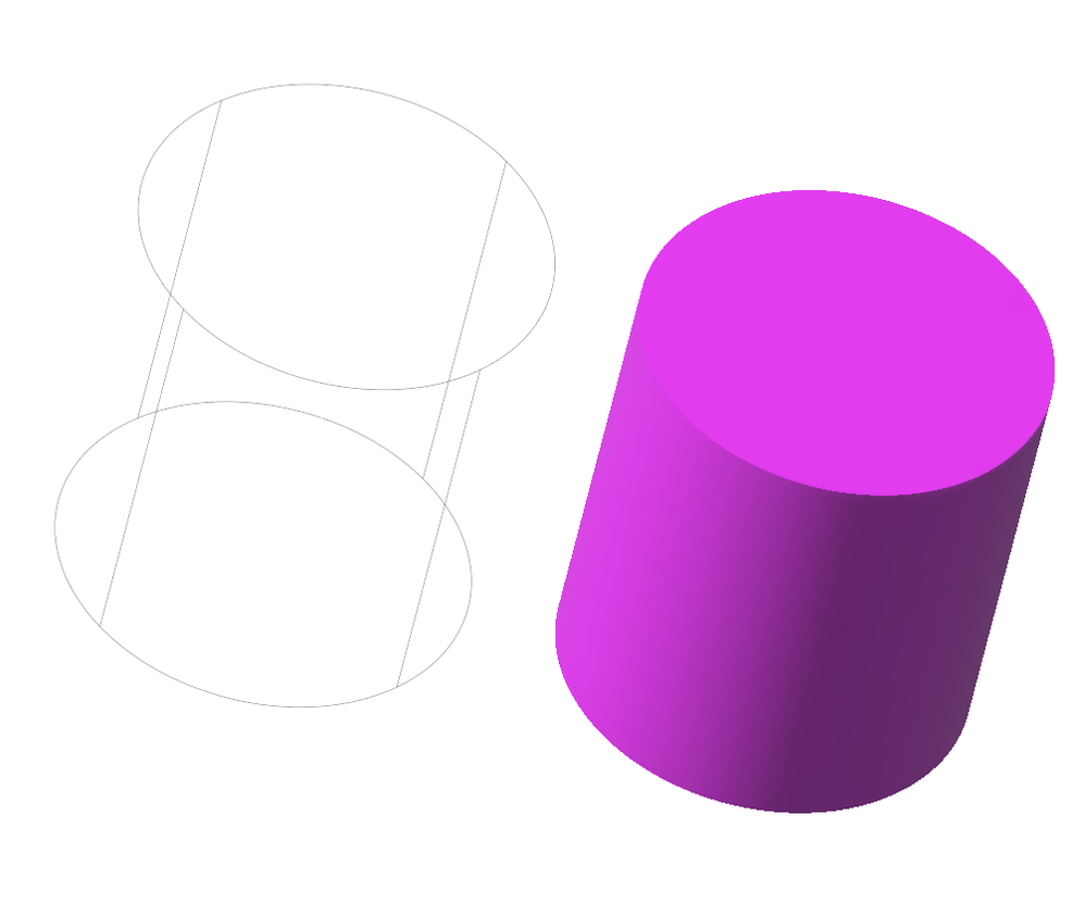

Is that supposed to work comparably to the old 3D effect on expanding? It seems to still give non-native art, just with a 0.01 px stroke wireframe behind it:
By @Doug A Roberts
Maybe some time in the future.
But in some cases it might just help achieve what was intended.
