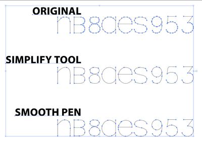

I have been looking for a way to smooth path lines as quickly and accurately as possible.
I tried to use the Simplify Tool but I didn't get the expected result.
The Smooth Pen Tool was the best solution, but I have many files and shapes like the attached file.
I think that the best result in relation to the original path may be created by a function to calculate the corners' angles and smooth the over 110-degree angles.
Is this really what it looks like in the attached file?
Can anyone build a script to create an array function?
Kindly help,
Regards

I tried the Round Corners effect, but the Simplify Tool still provides a better result.
The attached file contains path lines not outlined fonts.
 I hope this will make it easier.

Okay thanks. Yes I know the "font" is just paths. If a script was able to convert those into normal text, would that work, or do you actually need those paths smoothed?
Participant ,
Aug 31, 2022 Aug 31, 2022
I want to keep them as paths for Laser Die-cut use.
