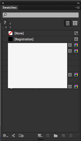

This is the before, with no colors in the scene at all.
This is after hitting the "Apply" button which opens some documents and grabs colors and applies them.
In that list, there are proc colors, gradient colors, and pattern colors(no spot).
In this image, this is what happens when I apply just ONE color from another palette to a pathItem/compoundPathItem.
It erases all of the swatches from the Swatches tab, but doesn't delete them from the artboard. AND if I save the scene, it corrupts.
Sorry for the long message, but that's the best way I could explain it.
