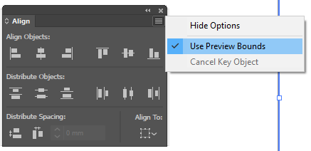

Is the 'Use preview bounds' option checked in the Align panel menu?

Hi Doug yes its checked.
Sep 17, 2019 Sep 17, 2019
Then uncheck it, because it causes this.

Thank you Monika this fixed it 🙂
