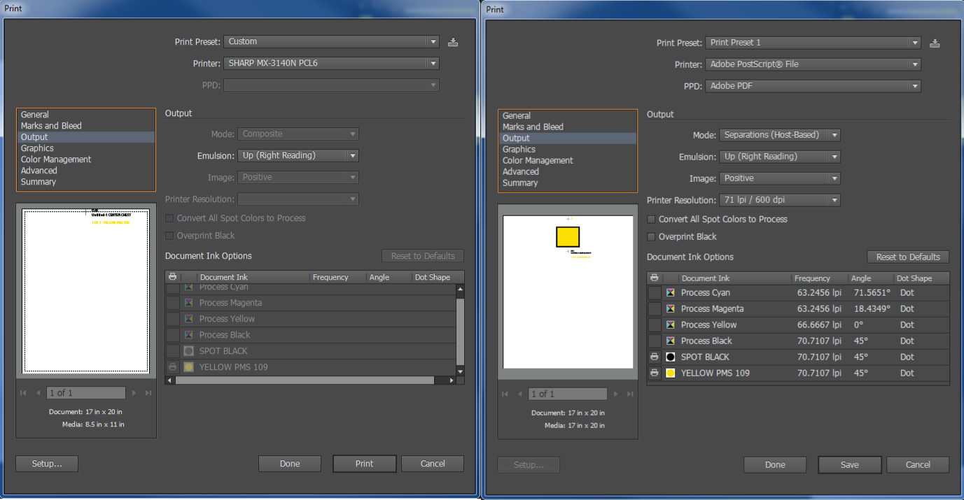

So one thing I just realized is that your print options do not go through until you use the print() method. This is very frustrating because I do not know what kind of Inks are being printed for the entire screen(s). When I open a document, it automatically defaults to the 8.5 by 11 media size, so if there is a color that is not supposed to be there and it is at the top of the screen, I am not going to know because the ink list is only for the 8.5 by 11 area not the entire 17 by 20.
You can see here, the left is what I am getting for my ink list, so spot black will show up as disabled for my script. The right is how it should be, but unfortunately those settings don't apply until after the print() method happens. So I am kind of in the dark on what all is being printed. ugh. If anyone has ran into this issue and found a good workaround please let me know. Thanks everyone and have a Happy Halloween!

So yea, for this to work correctly I would need to have the right print area before it prints. Through UI you can select a print preset and hit 'done' instead of print, been trying to find a way to do that through script, have not yet. Send Keys is always an option but that leaves room for error.
Tried looking for a way that Illustrator always has a print preset active no matter what file you open, haven't found that either.
An alternative would be to compare the inklist before and after print has taken place and then alert the user if it's different, but that would still create some work by having to go and delete files, and I want as little work as possible lol.
Guess I could randomly print something at the beginning and then define the inklist but that would be poopy having to print extra files.

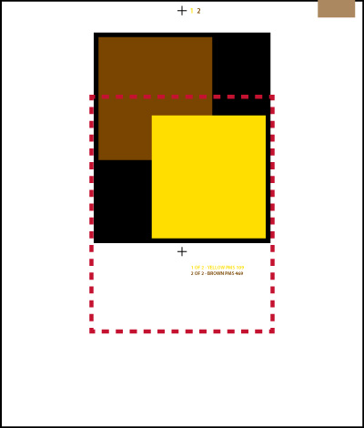

Thanks for looking at it. I know that all the colors are going to be printed, the problem is trying to catch colors that aren't supposed to be there before it prints. By the time artwork gets to me it is supposed to be converted entirely to spot colors that are specified. Unfortunately though, people make a lot of mistakes and there will be extra spot colors or even worse, cmyk colors still in the art. So I need to know what is all going to be printed before hand so I know if I need to fix something and I don't have extra screens in the postscript file.
Whenever you open a new document in Illustrator, it automatically has it set up for a 8.5 11 print area. Even though I tell it to use the artboard as the printing bounds at the beginning of the script, that doesn't take into effect until it actually prints. So anything outside of the 8.5 11 print area will not get detected.
The red dotted line is the 8.5 11 area it is looking at. I put a random cmyk square at the top right to test it, and it went through without being detected.
I added a dud print (a print I just save to my desktop that serves no purpose) at the beginning of the script with the correct print area before the cmyk detection, and then it was detected. So I guess I could use that as a solution if I have to, it just slows down the script a little bit.

Thanks for looking at this, it still goes by the print area for me even without the print options.
docRef = app.activeDocument;
var inks = docRef.inkList;
for (i=0; i < inks.length; i++) {
    alert(inks.name + inks.inkInfo.printingStatus)
Anything outside of the red dash area is showing up as disabled. I'm using cs6 maybe it goes by the artboard in other versions.
