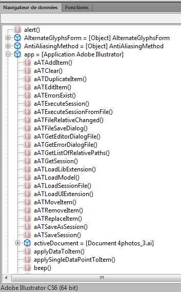

A keen VBA amateur scripter I've just started with Extend Script Toolkit for Illustrator CS6 64-bit (16.064). I'm getting a connection with the DLL and basic scripts work however even with small documents (under 1MB) I'm not able to list the document properties under the app object in the data browser (pictured as pending). It takes over a minute and hangs - this is a high-end gaming laptop with 34GB RAM so it's not a hardware issue. I never get to see what's available; obviously I can't code like this.
Does anyone have a fix?

so what's going on in the background when you notice this issue? is the script in the middle of executing? is the script paused at a breakpoint? was there a runtime error?
What is your script going to do when you're finished? In other words, what kind of processing is happening to the file when you notice this issue?

I'm not running a script, atm, it just usually will not provide me with info on the app i.e. selecting the drop down on app illustrator. Sometimes it will work but the majority of time it will not. I just got it to work on a file that was suprisingly big, yet on a clean minimal new file it didn't provide info.
Again to clarify this is nothing to do with the script, this is just merely seeing what properties are available in the current Illustrator app/ document.
It takes about a minute, as pictured it states pending in the data browser and just doesn't provide any further info. It doesn't actually crash, it just doesn't provide the info.
There's a blue spinning wheel in the ExtendScript App.
Illustrator itself pauses and becomes unresponsive. Sometimes if I wait it will become responsive again, other times it will not.

Advocate ,
Aug 27, 2018 Aug 27, 2018
Salut !
Application est l'application Illustrator.
Je ne pense pas que le document ouvert soit en cause ?
Le message d'attente dure une fraction de seconde. (ici Document 4photos_3.ai)
Je n'utilise pratiquement pas extendScript.
