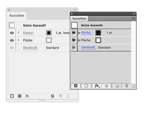

Mar 02, 2018 Mar 02, 2018
I can't see a difference between CS5 and CC here:
