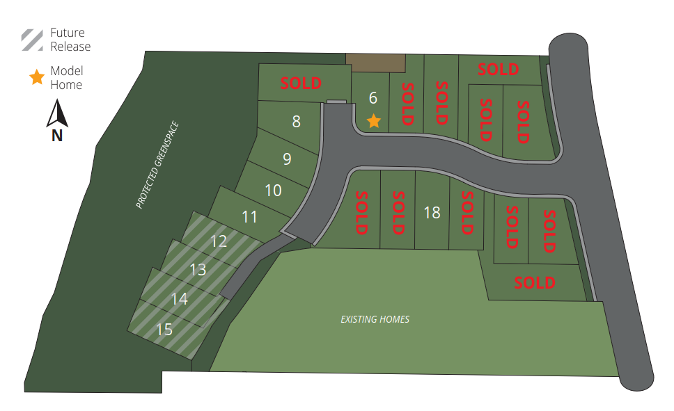

I have an AI file (attached) that includes an object set at 50% transparency. When I save the file as a PDF and print from the PDF, a darker rectangle prints inside the area of the bounding box of the transparent object:
We use PDF XChange Editor as our PDF software. The box doesn't show up in the PDF on my screen, only in print:
