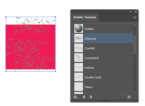

I am seeking help in how to apply ARTISTIC TEXTURES in Illustrator. I have found no information on how to apply these effects. Per the images, these "textures" are found within the SYMBOLS panel. As you can see, I have applied a charcoal effect to the example red shape using the SYMBOL SPRAYER. From this point I do not know how to actually apply (or imbed?) the effect to the shape. I am hoping someone can provide nexts steps. Thank you. textures 2.pngtextures 1.png

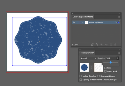

You can use the trasparancy pallet to use these as an opacity mask

I appreciate the reply. However, I previously saw the information in that link and unfortunately it does not help. That information solely explains how to add symbols. I am not applying symbols in the strict sense of the word. These are textures with no defined color(s).

It seems like a potential shortcut to creating distressed effects. I have done texture masking. I was just curious as to how to apply these specifically. The intent of my post was to inquire as to whether someone had direction to get me past the "spraying." I realize just spraying will not suffice. There has to be other steps I am missing. These effects are there for use, so I am curious as to how to use them.

That's what I have been looking for. Thank you! Much appreciated!!
