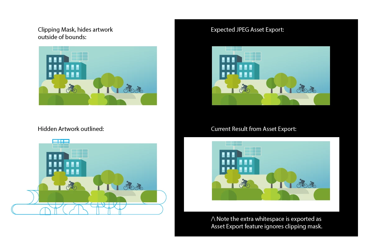

Note that Asset Export feature ignores clipping masks. Here is an image clearly demonstrating the issue:

It's indeed a bug, I fixed it by releasing the clipping mask and then applying the clipping mask again (make sure your asset is already in your asset export window).

This seems to be answered in
The answer is - it's a bug.
