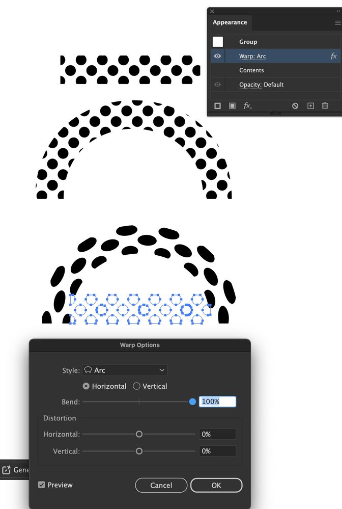

Like this with effects:
Copy link to clipboard
Copied
First one is a pattern fil on a rectnagle, then effect >> warp >> arc >> 100%
Second one is expanded, then pathfinder >> divide &pathfinder >> unite, then the warp arc applied
