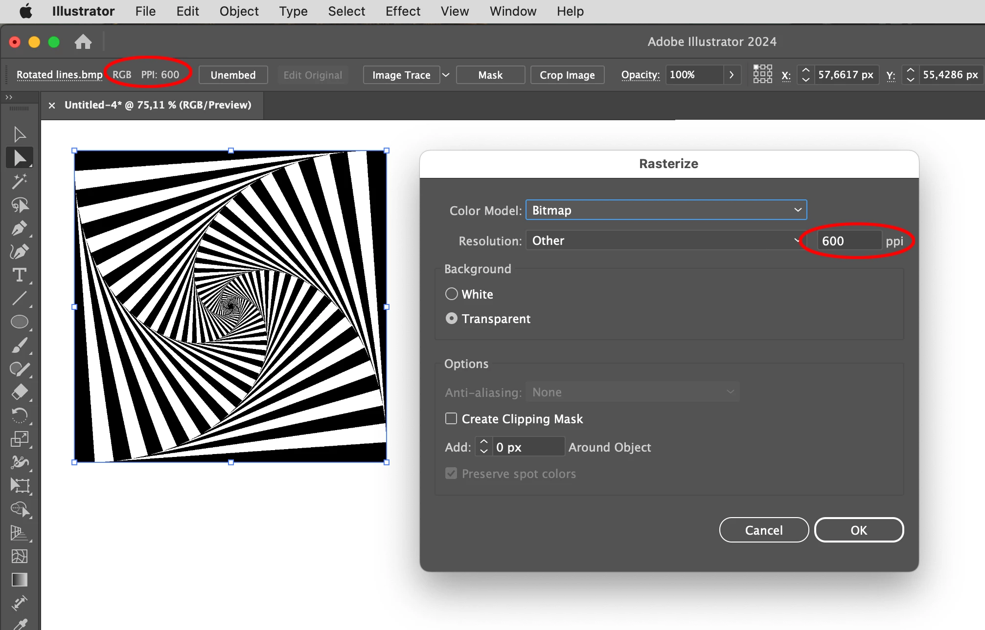

Correct answer Ton Frederiks
You don't need to revert to a previous version untill this is fixed.
Check the Control panel for the resolution, you will see that Illustrator thinks that the BMP file is an RGB file.
In this case the resolution is 600 ppi.

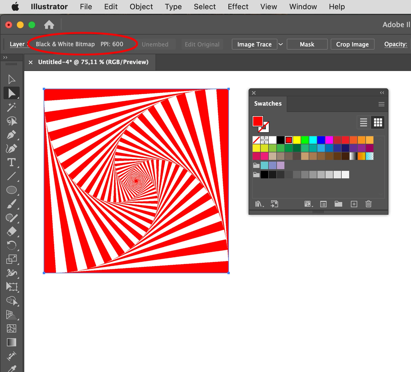

Use this resolution in Object > Rasterize and select a transparent Bitmap.
After clicking OK  you can colorize it.

Ton Frederiks
Ton FrederiksCommunity ExpertCorrect answer
July 16, 2024

Are these .bmp files? The latest version has a problem with those.
Try resaving/replacing them as .psd or tiff or install an older version (27. x/AI 2023) to edit those Illustrator files. You do not need to uninstall the current version, you can have multiple versions installed.
