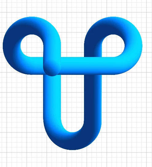

Hi I'm working on a logo like this.
It is one line logo, but overlapping part is a bit tricky. There are two vertical lines, what I want to do is the right one is behind, the left one if front of horizontal line. I found tutorials for one line object that have two both end. But my design is no end. How to connect it naturally?
I tried two pathes separate. but both end point would be visible.
It should not be that gradient 3d texture. Could be plain gradient colour like this
Thank you in advance!

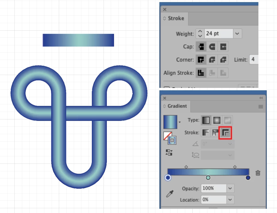

Ayako, hi.
Would you be interested in something like this??
Here I am working with strokes and a gradient. It gives you somewhat a 3D look.
It’s 3 paths, cut like Tina’s example.
Apply gradient across stoke.

Ayako, hi.
K
February 20, 2025
Hi, thank you for another proposal. It works well too!
