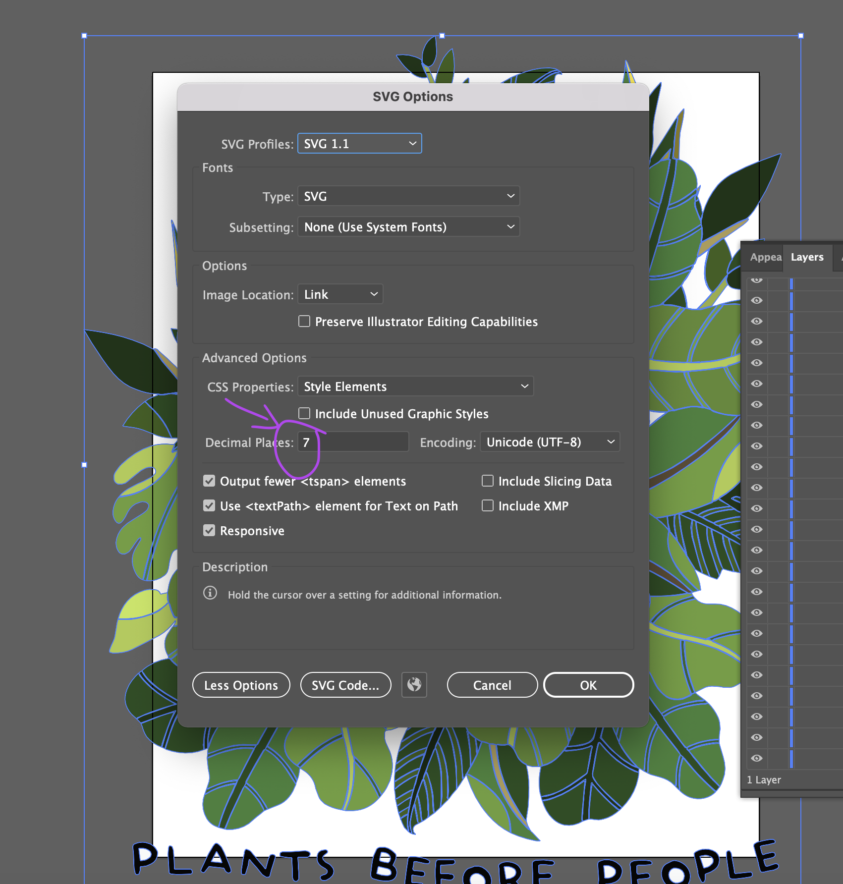

Apr 12, 2022 Apr 12, 2022
I found a solution, see attached 🙂
New Here ,
I know this is SUPER LATE but I have the answer whoohoooo!!!
This number circled must be 7 or above when saving.
I may be wrong and I am quite a novice but it works, try it!!
Community Beginner ,
Sep 29, 2022 Sep 29, 2022
This will make tracing work better in Illustrator, or will it make the svg export look better somehow?
It won't affect the tracing itself in any way. It will only make sure that the path you export won't get distorted further.
The "Save as" creates old code. Better to use "Asset export" resp "Export for screens". It will only accept 5 decimal places. But the Save as will only export 5 either. https://bjango.com/articles/svgpassthroughprecision/
