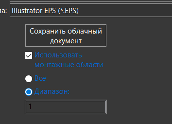

Place an additional checkmark in the "range" and then you will only have 1 file 🙂

I had this problem too, but I might have a solution. When you go to save an EPS file and you check "Use Artboards" you will also notice another radio button that says "All" or "Range" where you can specify a number. The Default is "All". If you instead select "Range" and leave the default answer of "1" or whatever Artboard you want, then you will only get one file and not 2. When you select "All", even though there is only one Artboard, the first file is significantly larger. I am not clear on the extra data that is included in the first file other than what might be outside the artboard and might comprise a pseudo-Artboard...? I don't know, all I know is that if you select Range, you get one .eps file not two.
Hopefully that helps...good luck. 😛

I mean, the poster is correct that it saves only one file -- IF you do a 'save as' and not a 'save' (and even that's not consistent, because sometimes when I do a 'save,' it does a 'replace existing file,' and sometimes it does a 'save as.' I never know which it's going to do). AND it still puts a stupid '01' at the end, so if you already have a file (like a logo, in my case) that you're saving over, the original one stays, and it makes a new one with '01' at the end. Massively confusing.
I genuinely appreciate the tip, but for me, personally, it's just as bad as the original problem. 🙂
