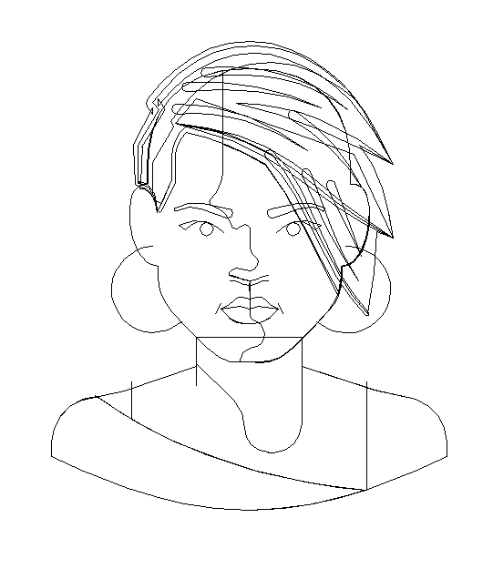

Could you please Click Ctrl+Y to see if there is any unseen object like clipping mask or any other objects that affects align commands.
Community Beginner ,
Jan 06, 2021 Jan 06, 2021
Not entirely sure what I should look for? This is what cntrl-Y gives me:
