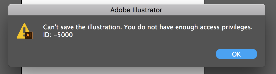

2
Can`t save the illustration. You do not have enough access privileges. ID: -5000
Enthusiast ,
Jul 02, 2018 Jul 02, 2018
I`m getting this error when trying to save a template to my local drive (File > save as template...)  Using MacOS sierra 10.12.4
I`m ok with saving out a normal .ai file, but not the template...have restarted illustrator with same issue when trying to save as template.

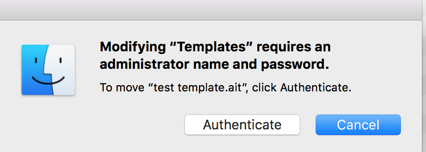

here are my mac functions, I dont know where to check access privileges, only see that I am able to login as admin, and when I moved the test template into the folder it asked for admin password which I entered..

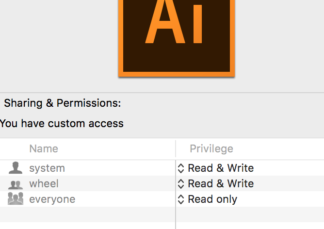

here are my admin settings and some of the utilities available.. I went to mac System preferences > users&groups

ok, the access information seems ok.
