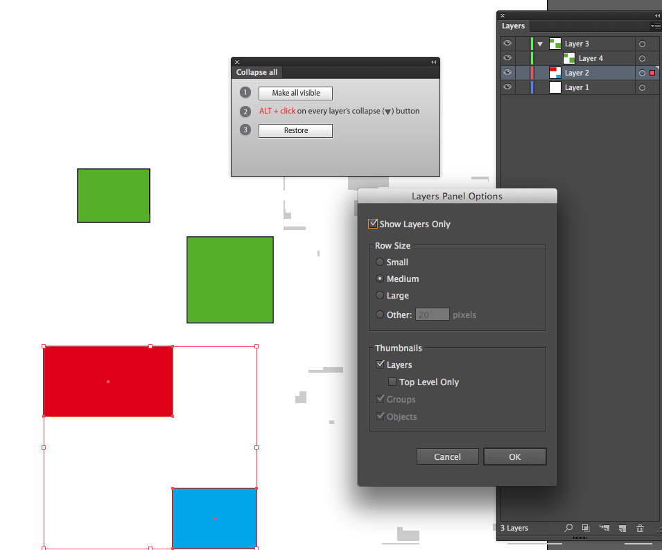

I hate that so I turned on the Panel option "show layers only".
And then I couldn't move objects anymore between layers by selecting and dragging the little square.

No item can be on its own as a <path> without a  layer on top.
Could you post some screenshots of what you're doint there?

true. the <path> was in the toplayer and came from a sublayer. see screens.
I now discovered that with the option 'show layers only' off, I can also move objects from a toplyaer into a sublayer in CS5! great!
by showing the <path> you can drag that into a sublayer. this couldn't be done by selecting the object when it was 'invisible' (as a <path> 'layer') by grabbing the colored square from the top layer into a sublayer (gave a 'no entry' sign).
thing is that in CS6 if the option 'show layers only' is selected, you cannot drag anything anymore...
so there is an extra restriction, rendering the "show layers only" option useless as working mode.
Why?

sorry, because of downscaling screens were unreadable.
now cropped and posted show all.JPGshow layers only.JPGagain

Thanks to this discussion, I was finally able to figure ot what was going on: By toggling the Show Layers Only button in the Layers Panel Options, moving objects from layer to layer via dragging the layer panel dot is disabled (it is still possible to do that from the contextual menu Arrange: Send to Current Layer command. The object one wants to move must be selected and the destination layer must be highlighted for this to work). This smells (stinks rather) like a dead tropical bug if you've ever smelld one.
